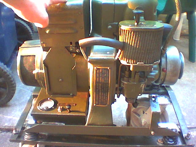

Hi all,
I just picked up a Homelite DC Generator WWII Vintage. I can't seem to find any information on this unit anywhere.
The Serial # is 43N10513 and it's specs are 28Volts, 70 Amps, 2000Watts. Anyone have any information or a schematic for this unit? It runs, but needs a fuel pump, and Tank.
Any informtion would be helpful.
I've Attached a few pictures...
Aaron

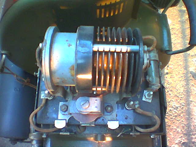

Under electric cover

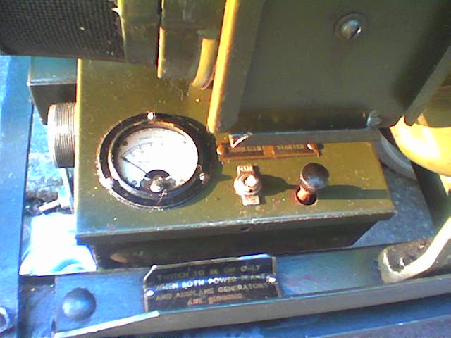

Control Box

Yep Aaron, that's a Homelite alright. In all the years I've been collecting generator literature, Homelite stuff is supiciously absent from my collection. The macines themselves are much easier to come by. At least yours seems to be in pristeen condition.

And I LUVV that old carbon-pile regulator (the thing with the cooling fins on it inside the control box).

I don't know if it helps, but I just picked up two old trash pumps at an auction with engines that look about the same as the one on you generator. I also would like to know more about them.

Looks very similar to the Homelite Electric Generator, model HRU-28 Power Plant Assembly which is rated at 1500 Watts (45 Amps) @ 32V. I have a poor origional copy of a manual covering the above from Acme Fan & Blower Co. Ltd., Winnipeg, MB (Canada) The manual is 4 pages and includes a schematic. Don't know if the schematic would be of any use to you but I'm willing to photocopy it and send to you if you let me know.

Homelites of this era didn't have a fuel pump as such, the tank fed the carb tube directly, with a non-return valve ball at the bottom of the suction tube.
The fuel tank is pressurised by crankcase pressure and keeps the fuel tube fed while the engine is running.
Mt handbook is for a 24A120-23 Homelite, yours looks a little more modern but the same carb and hand start appear to be fitted.
A blowlamp was also supplied according to my handbook for starting in cold weather!

I saw a unit like this sold on eBay a while back. The auction description said that the unit was missing its gas tank but the photos showed a unit with a gas tank. I quized the seller about this and he replied that he had previously peddled the unit in a deal where the buyer only wanted the tank and hence the secondary sale was taking place. It was a very similar unit, if not........
This summer, I took extensive onboard tours of both a Consolidated B-24 Liberator and a Boeing B-17 Flying Fortress. For those who aren't familiar, those were both 4 engine heavy bombers in the U.S. Army Air Force for the duration of WWII, truly historic aircraft. The aircraft that I saw were fully restored and flying paying customers. For eight bucks, you could go on board and walk all through, excluding the cockpit, tailgun, and nose, but you could crane your neck in there too.
Each of these aircraft sported a mounted generator as auxillary power unit (a.p.u.) just like your genset. I believe they were 1500 watts, and 28 vdc (or there-abouts). The cap on the gas tank, when removed, doubles as the oil measuring cup, the instructions for mixing are cast lettering on the cap's top. That detail sticks in my mind.
I spent several hours on these aircraft and looked the gensets over fairly closely. I have one mediocre photograph of the a.p.u. on the B-17. Same as yours to the degree I can discern. The a.p.u. on the B-24 was alike. I don't know if these were standard on most or all of these aircraft. I suspect that they may not have been. I have no info about the logistics of the a.p.u. installation- military aircraft often left the factory and were flown elsewhere to get modified and equiped.
I think your gen-set is an up-and-coming collectable. I can't say for sure what exactly your unit is, but there's my guess.
