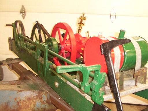

Picture of my New Record Drawsaw.

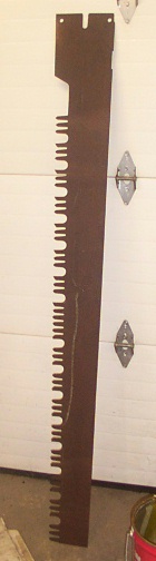

Heres a pict. of the 6ft. blade for my vaughn. Ken that is a very neat rig. What does it have for power. I too have never seen one like that!BObRR

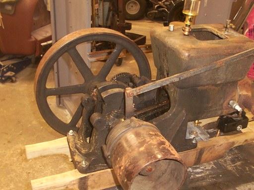

BobRR
Default Re: Drag saw blades, would like few pics posted
Heres the saw.BobRR

Here ya go Don. This one came off of a factory buzz saw rig.Tried to buy the whole thing but They mounted a electric start briggs on it and still use it. BobRR
