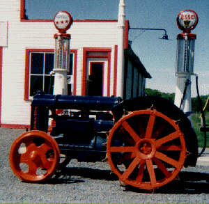

The Fordson N was built from 1929 to 1945. The first ones were built in Cork Ireland and are quite rare. The later "N"s came out of England are are a little more plentiful. I would need to see a picture of this Fordson to know for sure what you are looking at.
http://www.enginads.com/photos/smokstak/pic69947.jpg

I just bought one like the one in the picture of the previous post. It's still in it's work clothes and does not run. It supposedly was driven to the spot where it was sitting 40-45 years ago and sitting there all this time under a piece of metal roofing. It is all complete and the tin work has a few minor dings. I gave $800 for it.

Denis, that is exactly what I am lookin at but it is red and gray. Wish I had more info to give, next time I get out that way I will try to get more info. thanks for the rough value ideas.

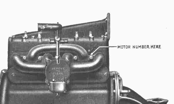

Get the serial number of this Fordson N and I'll tell you exactly what you are looking at.
http://www.enginads.com/photos/smokstak/pic69980.jpg
