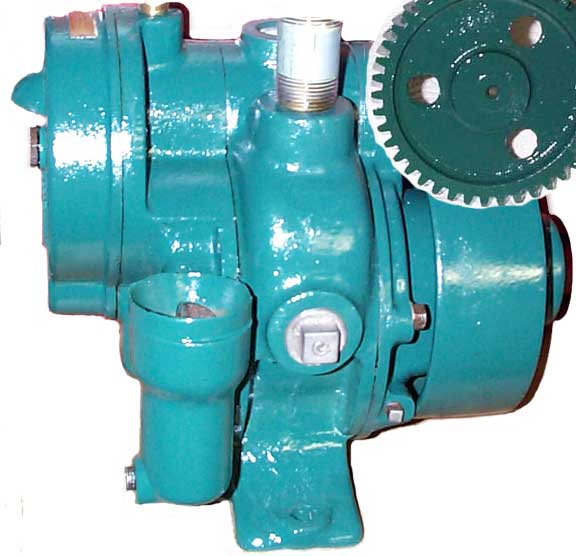

Default Color - it's all in the lighting!
Here's the pump after three day's paint cure, with the flourescent lamp off.
The cam gear is painted out of the same spray can, but same day cure and a DIFFERENT flourescent lamp!
SAME PAINT!

I finally got the color situation figured out and had Sherwin Williams mix up a gallon for me. A quart would have done all my work, but I didn't want to go through the special mix deal again.
This is my first time painting an engine with a brush. At first I was apprehensive, having been through a host of spray cans. The secret is to use paint thinner to get the right flow texture to reduce the brush marks. Also, spend the money and buy a good brush!
Here's the result...

Old 01-16-2003, 09:12 PM
Default Re: Alpha DeLaval Getting Closer
Getting closer to the finish line, but it's a lot of work. This photo came out bright - it must be the flourescent lighting. By the way, that idler mount is upside down. You'll see the whole assembly in another photo.
