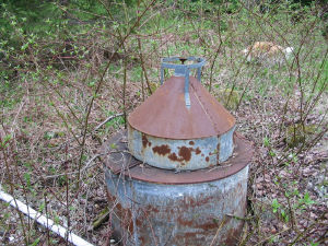

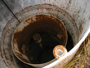

Robin DeLoria
Default Re: Carbide Lighting System
Photo of Generator
Old 05-20-2003, 07:45:58 PM
Robin DeLoria
Photo of Generator
