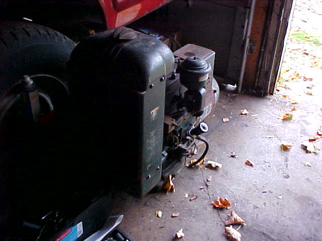

Looking for info - and value - any interest? I have a Military Generator-water cooled, is 115 Volt and 3000 watts. Generator number 5039/292271 and amp 26,64mx4930e-01 Zenith. Gas engine, two cylander flathead. Two coils, radiator with fan. Engine has frost plugs. Made by Donaldson Co., St. Paul. Engine block #wzc12004. Appreciate any info. or if any one interested - Please contact me at cmetinag@yahoo.com.Thanks

Sounds a lot like an onan in gisguise. Got a picture??

thank you for your help. did you get the photos? heres one more rick

here a photo

My neighbor has a mystery engine. Looks like the 4 cylinder version of yours. Radiator's are similar. IT is OD under a oiling instruction dataplate (Non ID) so I am 99% sure its military, but we have no other idea what it is. Its a flathead V-4. Whatever it was driving was belt driven.
Any ideas of vintage or Manufacturer?

I do not know what the little V-4 water cooled engine is BUT I have a good magneto for it. I was given the mag. I thought it might have been from a 4 cylinder Olivar tractor but it is for the engine you have. From the color left on my mag, a dark green, maybe the color was a blue/green like kohler used. It is hard to tell as the color is deteriorated.
Hope you find out what you engine is so I will know what my mag fits.

I should mintion that I do not think you unit is a militarty engine because most military engines used the sealed/ shielded ignition system.

You have an Onan genset. What the model is, I have no idea.
When I was in the service (many moons ago!), I had a part time job and my boss had one of those in his amusement parks' service truck. It started automatically when a load was put on it.
Neat little set.

Looks to me like you have an Onan W2C. Look at the pair I have:
I have reprints of the owners manual available. E-Mail me if interested.
Kearney 99 -
I have never seen a V-4 version, but it also looks like an Onan engine based on the radiator & head appearance.
As K D Redd stated, it is probably not a military unit based on the igintion. That color was Onan's standard paint scheme in that era.

The 4 cylinder unit is probably a Onan V-45-M engine on a PE-90-A Power Unit ac/dc 400Hz unit combined about 4KW.
