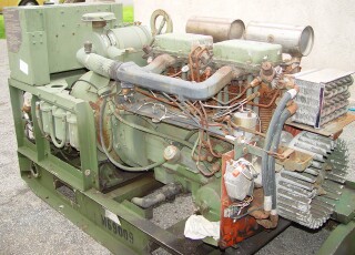

Thank You Rick... I tried that link before but I could not get it to work. I guess I wasn't doing it right but I got it to work and it is just what I needed. The first link closed down my browser also so I think it is there server. I am running a Pentium 4 3.2 Ghz.cpu Windows 2000 OS. Do you or does anybody have any ideas where I can get some sheetmetal parts for this unit. I in particular need the blower housing and the right side cover and wiring harnesses. I am sending a picture of the generator so you can see the layout of the unit. I have several diffrent Onan generators both are 4.0 kw one is a cck but this beast is my favorite unit. I love military overkill, this MEP003-A is only 10 Kw. but weighs in at 1220 pounds. I do not have the TQG but there is a sound attenuating housing for this one. I also someday will get my Hummvee. Is anybody here in California? Thanks Jim

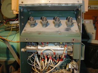

Well I have not had much luck in finding the sheetmetal parts for this generatos so untill I can find some origional parts I decided to build a replica of the origional one. Using the pictures in the Training Manual and looking at lots of pictures on the internet of DJC engines and other MEP units I came up with a design that is better then the old one. I made a mock up out of cardboard and then transfered them to a drawing. At trip to the sheetmetal shop and they cut it out on the shear. Then I just mig welded it together. I am stll in need of some of the wiring harnesses or at least the multi-pin connectors. Should be ready to start as soon as I make a stack for the exhaust. Check out the size ot the terminals where you connect for the power the split bolts are 1 1/2". Jim

Yes Jim, the split bolts seem like over kill but the military made these "handy". Sometimes distribution panels were used, or locally fabricated. With that generator, you can build one helluva distribution panel and get any flavor of sparks you want. Would you post a picture of the multi-pin connector?

all i can say is WOW!!!
that is SOME HECK of a selectro switch... to carry all that amperage on a rotary switch, with that many positions.. sakes alive! whats the kw rating on this generator? i have a 12.5 kva military unit, 3 phase made by john reiner co (no info ANYWHERE on it). i basically used the gen end and the fluwheel and housing off the old engine (it was a stuck continental), to mount it to my y112. unfortunatly im stuck using a change over board, with wing nuts and copper bars, id love to have a selector like that.
im in the process of building a control panel from scratch, but i dont quite have the time to get organized about it right now...
