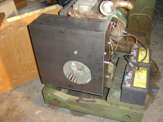

Well it's been a few days since I have been able to work on my baby, I just about have the blower housing finished and I went and got the sheetmetal for the side cover. It has been in the high 90's here and now it's raining but I needed to go to work for a few days to get some $$. I should tell all about myself, I live in Southern California, married, 54 years old, work when I can as an engineer for a management company specializing in electrical, I fix what the others screw up, computer networking, licensed heavy diesel mechanic, worked for the county, repaired and maintained 200kw. Sullair and Cat standby generators for a medical center. I am known around here as the real life MacGyver. I said I work when I can because after the last drunk driver totaled my truck and ruptered 6 disk and fractured by back, It's time to SLOW down... Sorry sorry sorry..... Anyway, I have the blower housing almost done and now I will start on the rest this weekend. Rick, I will post a picture of the missing connectors as soon as I can uncover the set. And good idea about the grounding, there is a very large lug on the front to connect to the ground rod. I would hate to get hit with this thing.. I could probably hold private executions with this. I was reading in the training manual and it says this unit actually flashes the field every time it is started, guess they don't want this to ever fail. Thanks for lending an ear, I will keep all informed as the project progresses. Jim

It's hard to tell from the picture, but that looks like an engine I aquired a few weeks ago. Mine is missing the air shrouds also. No generator with mine. Show us what it looks like when you finish the shrouds.

Its "civilian" counter part is the Onan DJC. Nice sets...

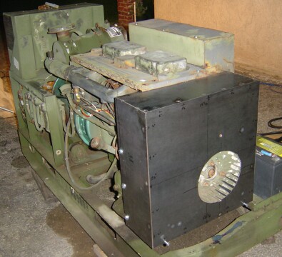

Well a couple of emergency jobs came up and I did not get a chance to work on the engine but I got some done today. My way to celebrate Easter... welding and grinding sheetmetal. I quit about 10:00 P.M. tonight when I broke my drill bit I am going to bolt the front of the housing to the side so I can check the governor and 24 volt charging system without pulling the cover. I next will have to build the side cover that encloses the top side of the cylinder heads and then it should be ready to start. I will try to get a good picture of the missing connectors and get them posted. I am not sure about where you live but last week diesel fuel jumped from $1.85 to $2.19 and it seems to be going up about .10 a day. I know these generators can run on jp and other mixes but do you know how they run on biodiesel? I drive a Dodge Ram-350 with a cummins and I am thinking seriously about making my own. $50.00 every 4 days is starting to get my attention. The sun will be up soon and I got to go to bed, I will be back soon. Jim.

Hello again, Well I started welding the side cover for the genset and then this 100 degree heat hit and alot of work came up all at the same time so I had to put it on hold. Then last Tuesday, I was installing a video survallence system in a town called Rialto and I got robbed at gunpoint by 2 drug addicts, they took all my money, cell phone, misc and and then when they left, they shot me in the back 6 times with a .22. Thank GOD I survived... I try to keep busy so I do not have time to think about it. Now I have some friends with a house about 90 years old and it has a elevator in it I am trying to keep running. I need to do some work on the contactors because the contacs are burned. I cannot find and diagrams on it or dates but it appears to be from around 1920's from the looks of the parts. I think it is called a "Sheppard Home Lift" and the name plate says it was made in Cincinatti. I know this kinda off track but I am hoping someone may know something about them. It uses a 120 volt single phase motor driven gearhead and a roller chain to lift the cab. If it would help, I will post some pictures of the unit soon as I find them. Hoping to hear from you soon. Thanks Jim L.
