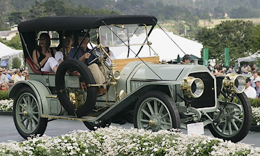

Two early cars that ran counter clock wise were the sterns and brush. The 45-90 sterns pictured has a 799.1 cubic inch motor.

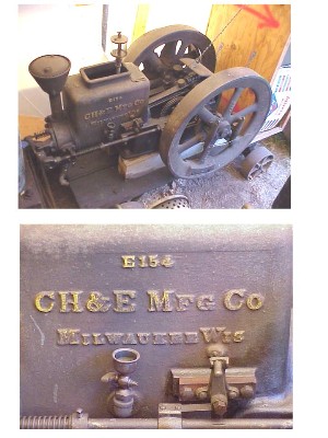

Had one heck of a time trying to get this CH & E started. Seems everything was "BACKWARD" . The starting lever in the flywheel kept pinching my hand . Hmmm.. must be a counter clockwise running engine, . Run's fine in the right direction . Paul in NJ, working O.T. on 3rd. shift for more toys . Just taking a short "BREAK" to check out Harry's.
