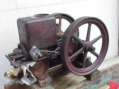

This " WAS " my first, IHC 1HP Titan Jr, engine. Really " NICE " . Paul ...

This is my SECOND IHC 1HP Titan Jr. engine. Still, another " NICE " one. Paul
