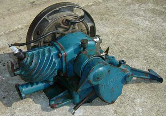

My knowledge of Maytags can be easily summed up in one word "NOTHING"!
That said, I came home with a trunk full of 92's 31's etc a few weeks ago 'cause I just couldn't resist 'em.
I easily got a couple of them running without knowing what I was doing but my 9 yr old daughter asked if she could have the blue one ( who knows why someone in it's past painted it blue).
Of course, that one was seized and had a few other maladies (carb missing, ignition problems, etc) but how could I tell her daddy couldn't fix that one.
It came unstuck much easier than I was expecting and I've scrounged a carb and ignition parts for it and sure enough it fired a few times on the first effort.
Now for the problem....It will start on the first or second kick every time but will seldom keep running more than 7 or 8 hits before stalling. The hits are generally spaced pretty close together too.
I'm sure I've got the governor settings way out of adjustment and I've ordered the tool to set the timing on the points. I'm also replacing the carb gaskets.
Anyone have any suggestions of what else might be causing it?

I assume that you're dealing with a 1cyl. Pull off the carb and make sure that the check ball in the pickup is not sticking or missing. When it first starts hitting, try placing your hand over the intake...if it continues to run, it is likely the check ball.

Neale, Take your carb off, make sure your check valve is free. Remove the plug from the bottom of the carb. I use a 7/8" socket with a notch cut out of it to go around the breather tube on the carb, but you may be able to get it with an open end 7/8 or a Vice Grip. It may help to tap on the plug a bit with a hammer to vibrate the threads a little. Also a little heat from a torch will help get this loose. There is a small spring which holds the air valve up to its seat that must be in good condition for it to run right.
It is very doubtfull that your timing is off, unless you or someone else has had the points off. The governor setting can be set after you get the engine to run right. Just make sure there is some tension on the governor spring right now. Good luck! Let us know what the problem was.

I had already tried "choking" it with my finger with no success so I figured it had to be an ignition problem. The whole magneto plate is so easy to change (I learned this today) that I just swapped plates with another engine...no help!!
OK...need 3 things...Compression...Yep..got lots (I honed the cylinder after getting it unstuck. The rings reseated very nicely.)...Ignition...yep...I swapped magnetos...Fuel...hmmmmmmm.
This carb uses (or NEEDED as I found out)the small, flat disk as a check-valve in the pickup tube. I borrowed a disk from another carb and that fixed it. (Chris...You were on the right track!)
Can anyone tell me how to go about adjusting the governor now that I have it running?
Now I need to figure out where the start lever return spring hooks up. It doesn't have the attachment on the forward lug like many of them. I'm also hoping to find a new start lever gear at Portland next week.
Thanks to all & Thanks Harry

On models like this with no lug to attach the spring to, just attach it to the skids that you mount the engine on.
The governor on these engines is connected to the points. When the governor kicks in, the engine stops firing. Your governor has a weight connected to a spring. If you want the engine to run faster, increase the tension on the spring. This holds the weight in, and makes the engine have to run faster before the governor kicks in. If you want the engine to run slower, loosen the tension on the spring. The governor will kick in quicker that way.

Drill a hole 1/32" in the mounting lug and put the return spring cotter pin through it. The cast iron drills easily. If this is not what you want to do, follow Tom G's advice. Good Luck!
