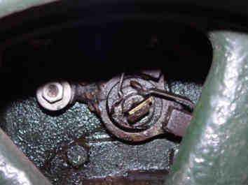

I am going to start this over so folks will see it-- HOW do I put a batt/buzz unit on my 2 cyl case-to try it---timers--ect---what-what-what--???how is it done on the original tractors that had it that way?? thanks d,j,
Old 09-24-2004, 02:32 PM
welchww
Default Re: starting problem
You need to make some type of timing device to fire the coils. This picture is how it is done on a 8 hp Cushman twin cylinder. Hope this helps. Wayne Welch

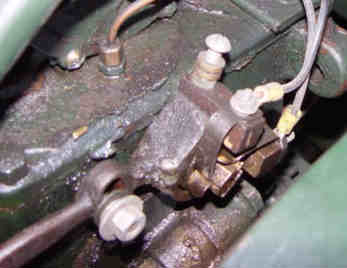

welchww
Another veiw of the timer. Wayne Welch
