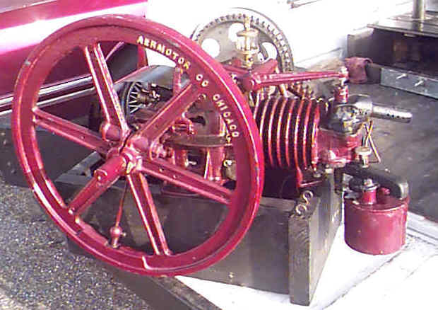

Glenn Karch
Photo Aermotor color - Red - Black - Gray
I am getting ready to redo an 8 cycle aermotor. What was the original colors or colors? Or do I just suit myself?

Doug Kimball
Default Re: Aermotor color
Glen, Most I've seen are black or gray, but have seen green & blood red.

David M. Lyon
I have only seen them in dark red, or machinery gray...I have never seen a black one. Mine happens to be dark red

John Hammink
Hi Glenn, what about this super dark grey color?
"Sixm" John

Frank Y
Glenn, I think the earlier engines with the dogbones were painted a gray color thats lighter than John shows and darker than mine. I heard at the end of the early run that they were starting to paint them a dark green, but thats just heresay. I personally like them when theyre gray but I could be a little partial. Frank Y

peter
Default Its grey
This is kinda a sore spot issue for me. I restored an 8 cycle a couple of years ago. Good luck, try and find an unmolested, origional paint, 8 cycle. I guess they are out there, but I was impatient. I bought mine, painted red, white and blue. It looked so silly! I left the magneto, red,white and blue-just for a talking point. I choose black. Now, I think I made an error. As far as I know the only known to be correct color is grey. Anything else is speculation, but grey is the accepted standard color. Just like there might be some orange JDeere, green is the JDeere color. 8 cycles are grey. My advisors suggested either black or grey was authentic. I dont like grey, nobody likes grey. Thats why you hardly ever see an origional 8 cycle. And somewhat unusual to see 8 cycles repainted grey. Anything but grey- red, or green or black- but not grey!
I bet someday origional and unmolested 8 cycles are going to be worth some real bucks.
I sure would like to see some images posted on Harry's showing origional paint 8 cycles.

Benny Mckheean
Default Re: Its grey
Look at Harry's engine.I saw one with original paint and it was gray just like Harry's
http://www.old-engine.com/aermotor.htm

Steve Baldwin in NC
I have 3 aermotors. One had no paint on it when I got it, one had been painted a light grey, and the last one has maybe 5% original paint and is a medium grey. In a post dated March 21, 2003 Bob Kubisch said he had owned approximately 2 dozen 8-cycle aermotors. He stated the early engines used a battleship grey. He states late into production they changed to dark green. They also used dark maroon and the engines that were equipped with the webster magneto were painted bright red.
