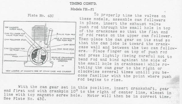

Say you FH guys, what kind of timing marks are on crank and cam gear I can't see any?? is it a dot or teeth filed ?? Thanks Guys

Dave Holtschult
Default Re: Repair/Replace Threads on Briggs FH Head
You dont use marks on a Briggs FH . Go to Antique Small Engine Collecters Club, go to the Technical Data board it tells you how to do it.Dave

Here is a scan from one of our books.
I could not find any timing marks on the one I rebuilt,so i made my own,lining them up withe key way
