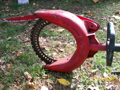

Take a look at this Antique Chain Saw Display to see a picture of the Sally Saw amidst other antique chain saws. I recognized the display instantly: the picture was taken at the museum on the grounds of the Fryeburg Agricultural Fair in western Maine (which takes place the first week of October every year -- definitely worth the trip).
And take a look at a close-up of the nose end of the saw.

Here is a my picture I posted for the thread over on the farm forum. I did that because now when I log on I search
for new posts instead of perusal of individual forums.
