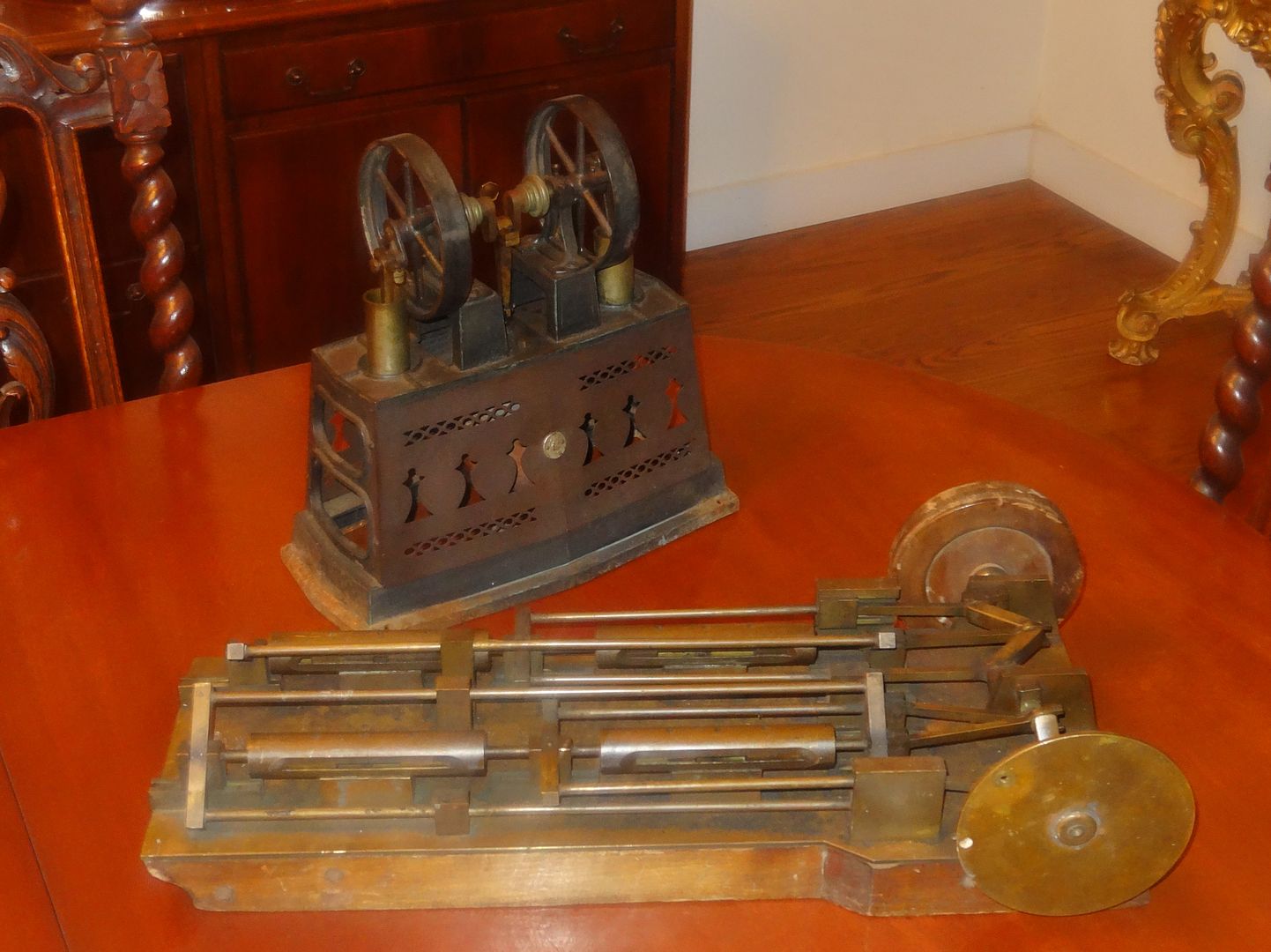

I managed to find 2 great pieces to bring home from the
Eliot, Maine Show 2017 at the Raitt Family Farm.
They put on a great show each year at the end of July.
This morning and yesterday I was able to acquire a prototype cut-away model of a compressor or steam
engine and a wonderful old large Marklin Stirling Cycle Engine with 2 flywheels and 2 power pistons.
I have learned a little more from an old Battenberg Sammler Kataloge from 1983.
The Marklin appears to be a very rare No 4102 from 1907.
The only picture I have seen of another like it was sent by a friend overseas.
He saved it from a sale about 10 years ago.

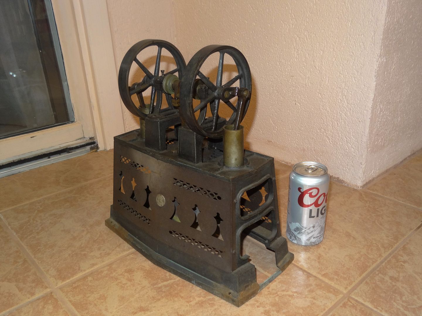

more pictures...

Update:
Yesterday I had one power piston rod disconnected from the crank arm and it wanted to run
with just one attached. I held the loose one in place so it wouldn't pop out of it's bore. I then
hooked it back up and disconnected the crank arm on the other end of the crank shaft.
It ran with the other one alone too......
HOWEVER.... it was in the opposite direction. So now we know the timing was way out of sync.
I gave parallel motion a call and we agreed that both power pistons likely needed to move
up and down together. He steered me back to Peter's picture of the blue one and pointed
out the power pistons on that one appeared to be set to move in unison.
After resetting the timing and wiping a little sludge from the power piston bores,
I have achieved a bit of success.
I know heat dissipation is not a highlight of this design so I thought it might need a little
cooling help from a couple wadded up damp paper towels which I found it didn't need
at least for the first 7 or 8 minutes, after which it began to slow down a bit. This when the
flame grew larger and larger as the burner heated up and began spewing more
fumes into the mix. I think an evenly regulated heat source would be much better.
Gil

Update..........
I decided to run it with a small Bix burner which is easy to regulate reliably.
I got a great result with a run that lasted nearly 40 minutes.
Below it is condensed into 7 minutes in this video.
Enjoy,
Gil
