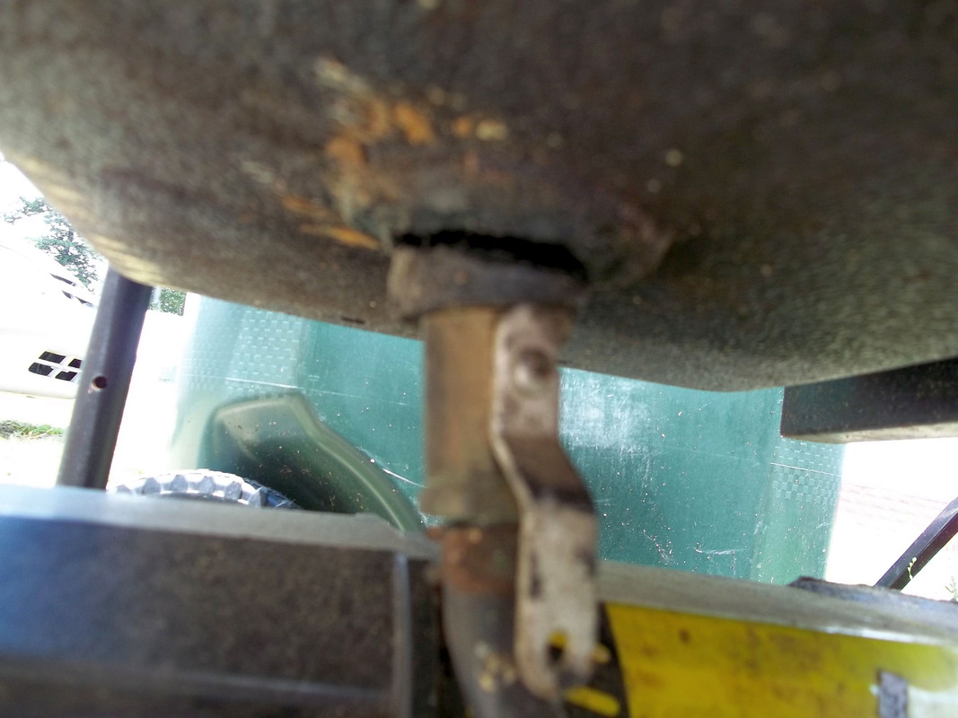

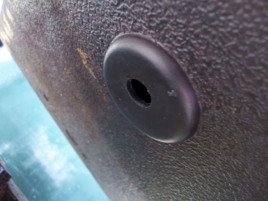

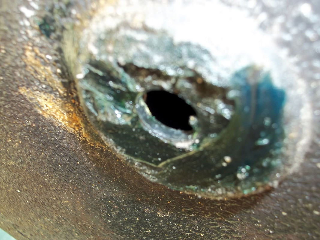

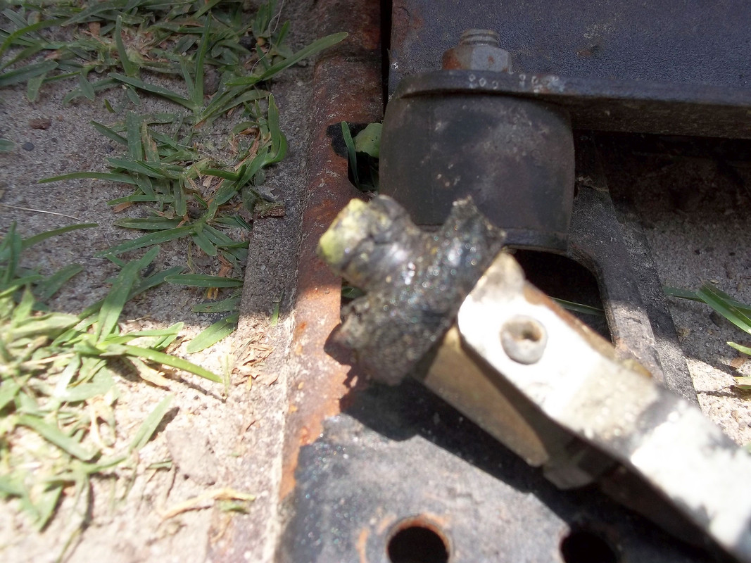

First fault I come across is the rubber fuel tank grommet was broken and has turned to a sticky tar like mess. Yuck!
After removing from tank.

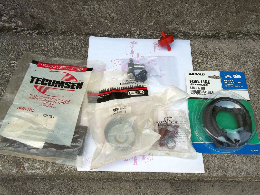

All the repair parts.
Fuel tank cleaned up with some carb cleaner spray. Nice and clean ready for new grommet and petcock.

New grommet and petcock awaiting some Vaseline before being installed.
New petcock and grommet installed.

turtmaster, Thank you for looking up the part numbers for the carburetor. I am probably going to leave the stock one and just replace the cracked bushings around the throttle and choke shafts. I've never been one to change things if not necessary.
I do want to make one change though, I want to replace the brass float with the plastic version. Solves the ethanol fuel problem of the solder being eaten and the float flooding with fuel.
Looks like plastic float is part #632816
