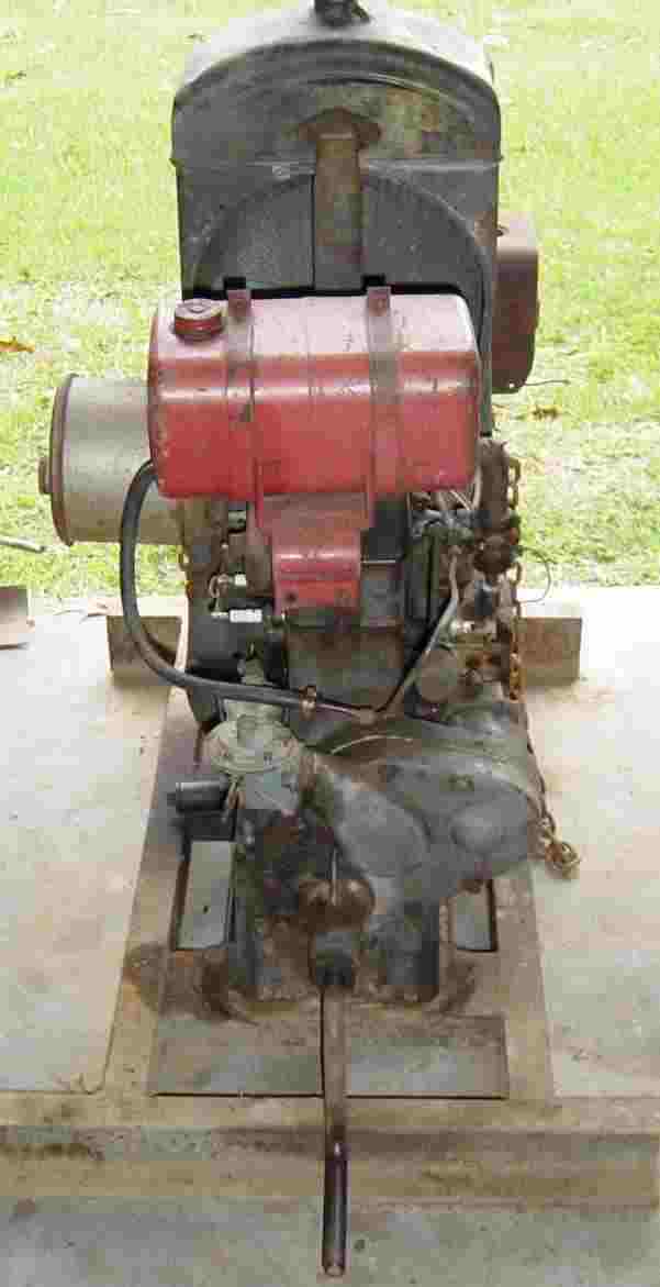

Ben Seger
Default Re: KOHLER LIGHT PLANT
This is a picture of the Kohler that I just bought. The red mounted gas tank is not original. I believe a glass jar used to be here also but am not sure.
Ben

Hey guys, don't forget that there was an add on accesory for cars back in the 40' and 50's that injected WATER vapor into the carb or manifold. It looked just like a fruit jar screwed into an adaptor. It was claimed to make the engine run smoother and did help to some extent. Could this be the purpose of the glass jar? Happy Thanksgiving! George
