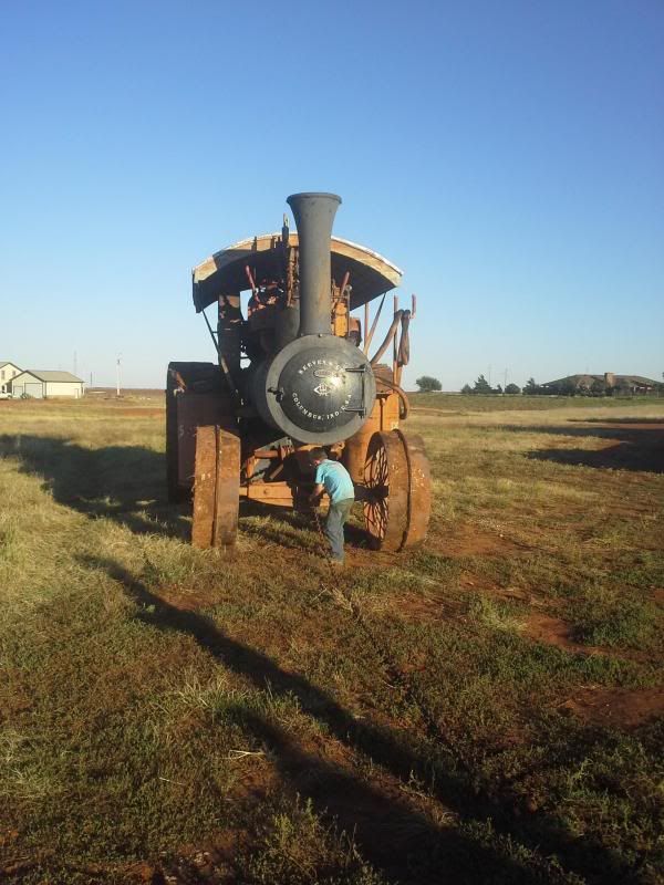

I guess now is a good a time as any to start a thread for the resurection of 4390.
We have quite a bit of info on this engine from the time it was new. Don't know how accurate the info is just what we know as told in a letter by a previous owner and passed along by assuming Bud Wagner as he was the first collector to own the engine when he rescued it from its location on an old sawmill in the fifties.
I'll have to scan in the letter and photos that came with the engine for all to see. If anyone has any photos or stories about 4390, Bud Wagner or Charles smith we welcome you to post them. I hear Bud was quite the character. I'm up for suggestions and any guidance or thoughts also on bringing it back under steam.
During the show at Fairview OK. this past weekend we armed ourselves with oil, penatrating oil, prybars, cleaning tools and a grease gun. Within about 45 min we had it making full revolutions by hand and all the valve gear working freely:D
Played with a UT meter for an hour or so it looks REAL promising inside and out:brows: If it goes well Mr. Mcknight just might pull the throttle next May at Pawnee:wave:
I'll leave you guys with a picture of my son helping with undoing a chain on sunday after unloading. He insisted on riding in the truck while hauling and unhooking chains after we removed the binders. After all this is what its all about right?

Did she spend most of her life in the belt? The skid rings on the fronts sure look sharp!
Yes it was purchased by a group of men that ran a threshing ring. They got to fighting and sold it to two brothers that operated a sawmill and that where Bud wagner purchased it. So the only draw bar work was done from the 50's till 1988 at shows.

No powersteering Beth. We were hoping it did but one can only get so lucky:O
They're not real good to steer, but not real bad either, if moving (as with any engine). The 40hp Gaar Scott is the biggest bicep builder I've ever had hold of the steering knob of.
Greasing the worm gears and oiling the moving parts help. Gary:O
Caleb Carpenter
The guy we bought this from had a crew of guys helping us move antique trucks and museum items out of the way. One tried to turn the reeves wheel and stated it would be impossible to move without turning. I disproved him in about 5 min with a bit of oiling on the steering cross shaft and worm gear bearing. Biggest issue was the pinion shaft was froze up and she wouldn't roll at first.

This engine weighs 35, 000#'s according to the grain elevator scales so its naturally going to be a bear to turn when not moving
