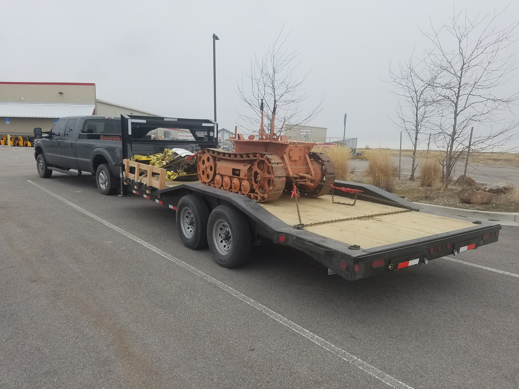

Hello... my name is bigGURN and I have a problem! I drag old tractors home, preferably in boxes. The more of the tractor that is in boxes, the better!
Well... I've gone and done it again. I found another tractor that I have taken possession of in boxes (I think this is the fourth or fifth, third Cletrac for sure). This tractor came up for sale last fall and I missed out. Then the new owner decided life just wasn't going to give him adequate time, so it came to me through a fair trade deal... my wife is quite impressed :bonk:

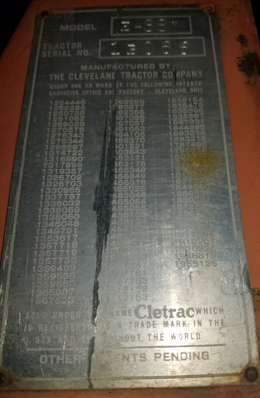

1934 Cletrac E-38:
After talking with Landis Zimmerman this is one of the earliest E-38 tractor off the line. As Cletrac Serial numbers during this time only ended in even numbers, therefore you must divide by two, that makes this the 33rd E-38 produced.

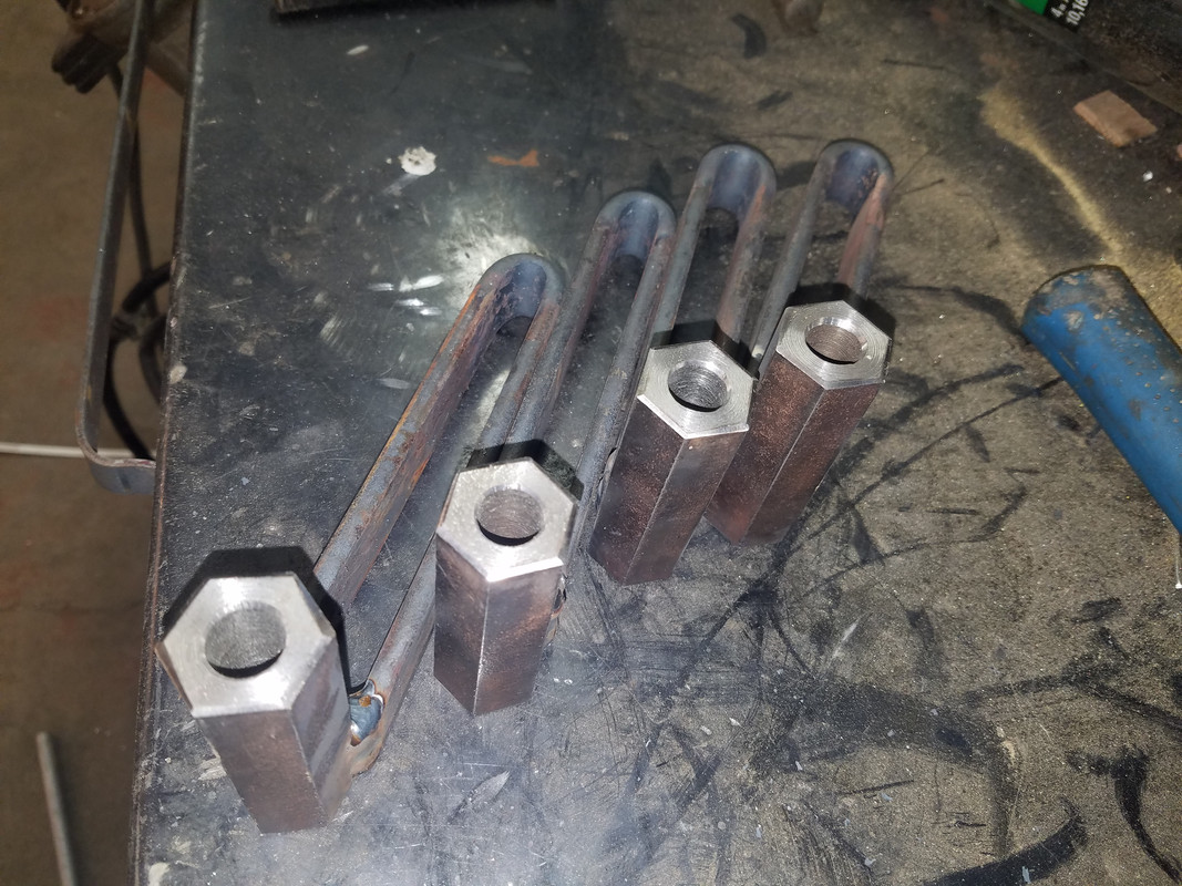

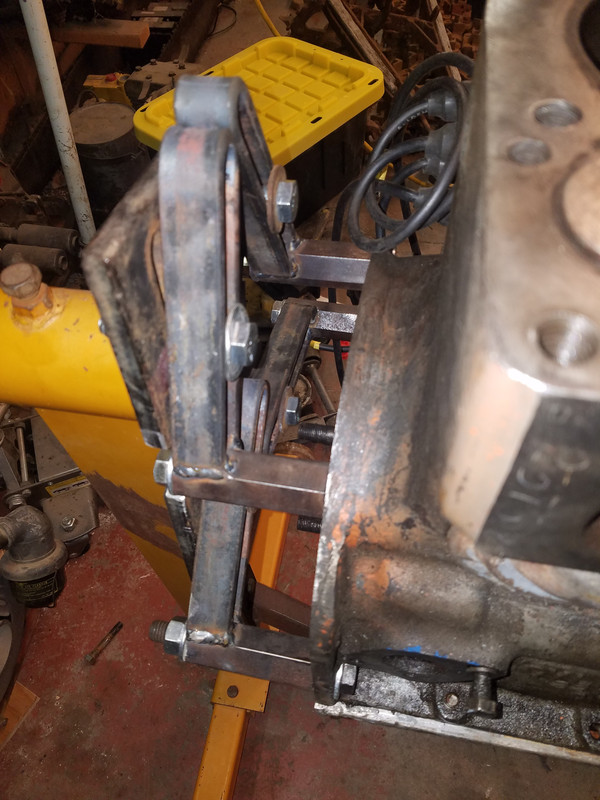

After some help from Lauren with machining some adapters that I made a new set of engine stand brackets with, I was able to check the condition of the cylinders

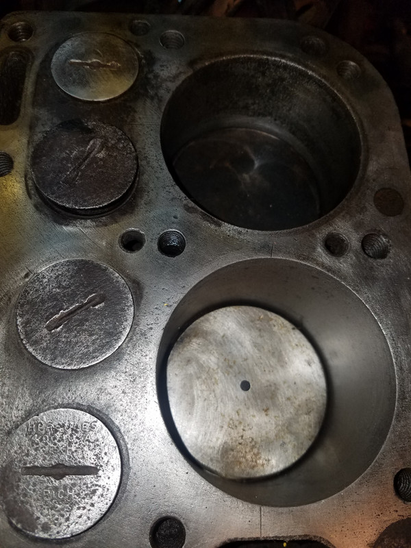

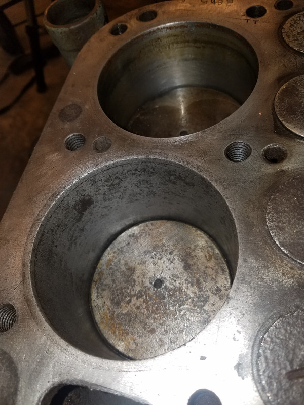

...at least two, if not three cylinders are going to need sleeved to make it right.
Interesting thing about this tractor: it should have a Hercules OOC with a 4"bore and 4.5"stroke. At some point it had a long block installed that is OOB spec (3.75"x4.5"). So I have several options available: Bore to OOC, sleeve and stay OOB, or there is a possibility of buying a complete OOC that a friend put me on the trail of... decisions, decisions... for now I need to finish the Vaughan Flex-tred sitting in the shop, but this is my food for thought as I work on finishing that tractor up. Stay tuned...

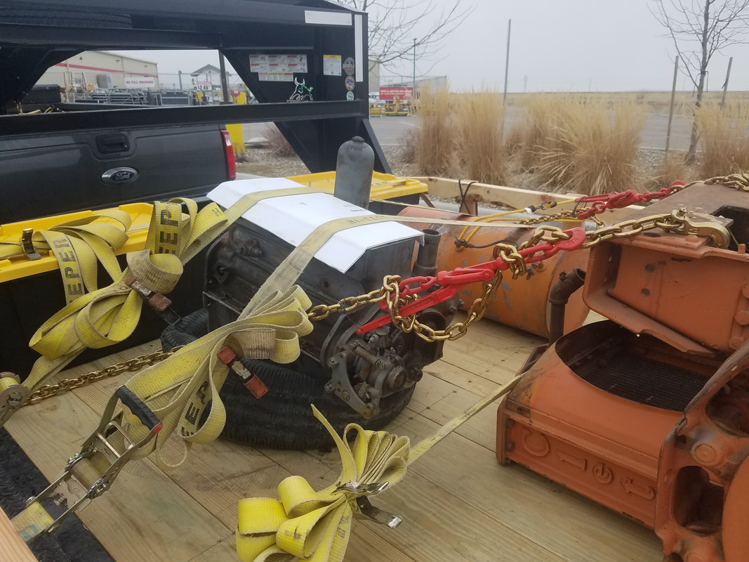

Fortunately this summer while out to the Great Oregon Steam-up I was able to follow up on lead for the engine and track down the correct Hercules OOC engine for this tractor. It was stuck and needed some work, but it was an engine! (On the left is a smaller OOA someone previously installed)
Today I started the tear down. Spent an hour and a half with the pressure washer and Zep Purple cleaner to get it cleaned before the tear down could start. Pistons freed right up and came out. The cylinders honed out nicely and should be just fine once the pistons are cleaned and put back in. One of the pistons has had the rod replaced with a newer rod with clamshell bearings.
The other three are the originals with nice, clean babbitt.
Of the eight valves, two came out. The other six required a 3/8 bolt welded to the face and a slide hammer to set them free. Only one guide pulled, not a major issue as I just added another guide to my order with the valves from Zimmerman Oliver-Cletrac today. Two will need new seats installed, the others should grind just fine. I'm down to just pulling the front pulley and timing cover... so far the pulley is holding fast. I'll keep heat cycling and applying PB Blaster. Hopefully I won't have to cut it off!
