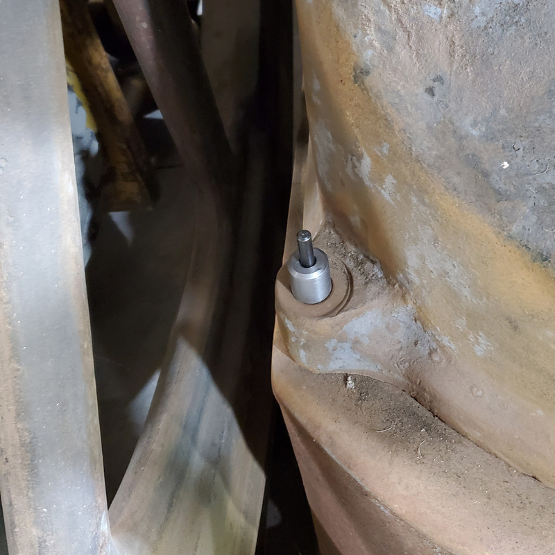

First up for the day was marking the base for the mounting holes. As the holes are just shy of 1-1/8" using a transfer punch wasn't an option since the set available only goes up to 1". No problem though, we simply machined a transfer punch guide to use with the 3/8" punch.
Once the base was marked, off the engine came for drilling the holes. The mag drill and a Hogue bit made quick work of the 1" holes.

Nice work with the transfer punch and bushing! And that is some first class fabrication work on that base for sure. You can't beat those annular cutters for big holes. Looking forward to seeing her run.

That mag drill is kind of cheating isn't it?
I've never used a bit like that but I can see they would be really good. Thanks for explaining how the bases were made.
