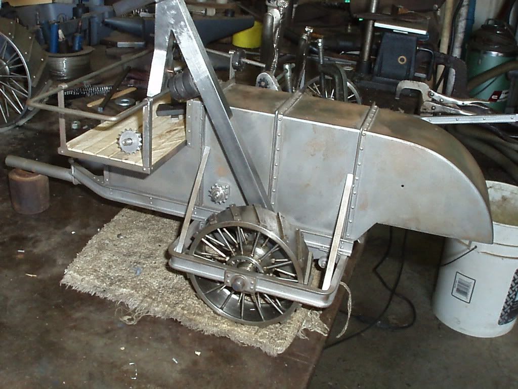

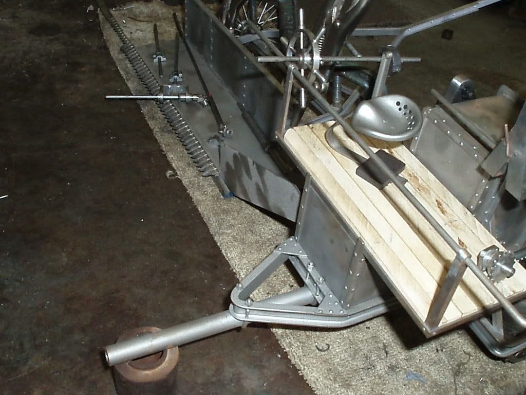

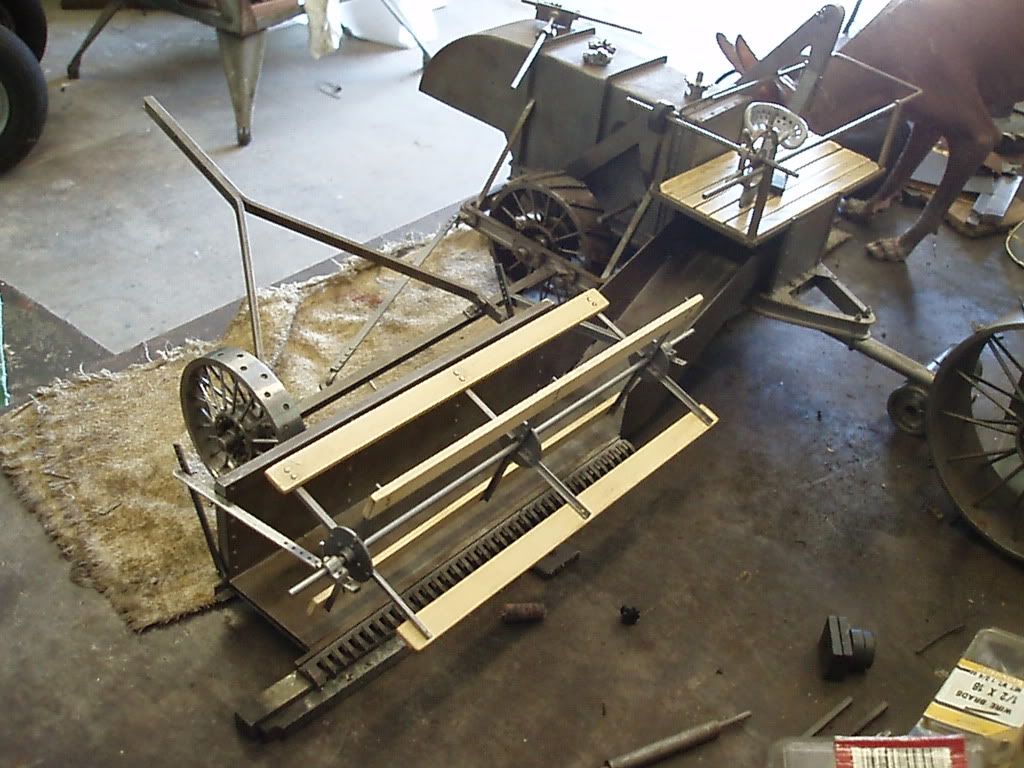

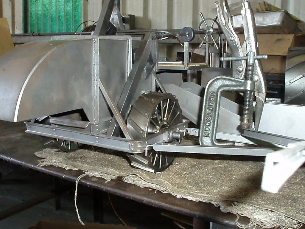

These are pics of the model combine I am building.All my own design. It will house the ignition system for the tractor that will be pulling it. You can see a rear wheel and one cylinder of the tractor in one picture.The engine has a .625 bore X .750 stroke. The header (reel,knife,and draper) will be functional by roller chain ground drive off the left-hand main wheel through the driveline, u-joints and right angle drive pictured, all handmade, and has a 7 inch cut. All the rivets are real, they are .035 brads that have been reshaped, the angle and channel iron have been milled from bar stock, the main frame channel iron is 1/2 inch wide, the hitch is hollow for the sparkplug wire, that is why it does not have the tiller wheel in front. There are 180 3/32 square spoke nuts with a #2-56 thread that had to be hand made from key stock. I have been working on it for almost a year now, hope to have it running in three. Thanks; Tad
More pictures here.

Very nice! I am very interested in seeing the tractor construction. My opinion, you can get small ignition setups now so you wouldn't need to hide it in the combine... What shows do you attend? Any chance you could bring this to the NAMES show held in Toledo, OH in April?
Forrest A
Tad Wicks
Hi Forrest A, I use the CH Electronics CDI ignition because it is small and it will work well with points or Hall effects, but not small enough with the battery pack which is 4 AAs. The tractor will be along the lines of the early Rumleys, Averys and Fairbanks and Morse about 1/6 or 1/8 scale I would guess. There is engine, wheels and radiator, no sheet metal, no place to hide things, therefore the combine, and I like my machines to be doing something (check out my hit and miss and pump down the list a ways) The combine will be the perfect hiding spot and it will be functional also (short of a very small sack-sewer) and I will be able to put it on the floor, turn it loose and watch it go. The engine was going to be a stand up twin but what I have made is a bit to large in scale so I might go to a single or an horizontally opposed, not sure yet. Fairbanks and Morse built a large single tractor with a 10 inch bore and a 16 in stroke. I can start another thread on the tractor and engine one day. I will probably never make it to NAMES but I have showed (shown?? showded?? hahaha) at the Cabin Fever- Men Metal Machines expo in Visalia CA. and the WEME in Vallejo CA. and the Pioneer Day festivities in Paso Robles CA. Thanks for the response. Tad

That is a great looking model. I don't suppose ya made a set of drawings for that?? I always wanted to make something like that but don't have enough talent to just free lance it, need a set of prints to follow. Again great job on that.
Tad Wicks
Hi James, sorry, but I have no drawings, it was all done by guess and by golly and by eyeball, of course, that does't mean that it can't be put to paper one day. I will probably have to finish it first, if we all live that long.The hardest part of this project has been the riveting, they are all functional, that is how it is held together and it took a long time to develope the tooling to make it look right. They are only .035 in diameter and they are all swedged.

Man that's quite a unique project. Excellent work on the build. It 's too bad you couldn't have found stock for the frame instead of having to cut it out of solid.
gbritnell
Tad Wicks
Hi John, the header is 7 inches, the overall width of the machine is about double that, the combine wheels are 3 inches, the tractor's big wheels are 5 inches. I think the tractor is going to be a bit big for the combine but that is OK, I wanted the combine to be about 8-10 foot cut in real size and the tractors of the day were quite large for their horsepower (Rumley, Altman Taylor, Russell, Titan, F&M) so it should look close to correct working at about an inch to the foot 1/12-1/16 give or take.
Otto Sawyer, I don't like my models painted, I like to see the shineys, whether it is brass,copper or steel. If it is painted you could not tell it from Chinese die cast, plus when it is this small getting the paint to go on properly without covering up detail is a whole different problem. The combine would have been all galvanized in real size anyway. I liked the idea of the v-twin but because it will fit in the footprint of a single and I wanted a stand up twin but it was too wide, I went 90 degree instead of 45 so I could put the cam in the middle of the engine instead of on the side. The fun part is I don't know of any tractor company that used a v-twin, so many things in that day were tried and failed, there was some very unusual stuff so I figured this would fit right in.
gbritnell, being able to find correct angle and channel stock would have saved so much time and effort on both the combine and the tractor, but I guess having to make it is what the whole thing is about. Thanks Guys Tad

on your v engines, are the cases split in half? if so you must have a two or three piece crank and fork and blade rods like the Indian and Harley. I opted for something a little different, I used a single piece crank and I haven't decided on the rods yet, they are on a common jurnal (the cylinders share a common centerline)but I think they are going to be either offset or rod and knuckle much like that in a radial engine, all held in by the endplate/main bearing but unlike the radial it will have a straight line cam, fork and blade rods with bolt-on caps might be quite a challenge at this scale. I have tried making three piece cranks for a tiny hit or miss, the flywheels really show and amplify any flaw in assembling the crank, it was just too hard to get everything perfectly straight with ''0.00'' runout.
All the angle, channel and I-beam was cut from solid stock, I sharpened cutters to copy channel iron with the radiused (radiuseded ??????:)) inside corners along with the tapering flanges, but is so small you can not see it so I ended up using straight 4-flute cutters with raidiused corners, it is very hard to tell the difference. I had to build a jig to hold the stock so that it can be milled to dimensions, cutting .1875 or .250 square to angle and keep it straight is a little difficult in any length. I appreciate your intrest; Tad

Maybe I can save you a bit of time when cutting you channels. I used a piece of 2x3 angle iron,(the heavier the better) clamped it square and true in the mill vise, surfaced it, then cut grooves with end mills the size of the iron I wanted to work about .030-.040. deep,(it doesn't really matter on channel but it does on angle) just enough to hold it in line, with the heavier cuts to be made closer to the web of the angle, then clamp it with the vise grip clamps every three inches or so, I have power feed so it is just a matter of adding and removing clamps as the work moves along, always add a clamp before removing one, it will show up in the channel if you don't, plus that gives it a chance for chips to get under it. I bought the cheap Chinese clamps at Harbor freight for about five bucks, they work OK for this. You can add a piece of square stock in the cut part to clamp on. When cutting angle irons, the sharper the tool the better, .250 angel will come out with a huge bow in it, if I need smaller angle than that I take the .250 and mill the legs down. For .5 channel inside cut I believe I used a .3125 4 flute cutter with .045 radius, actually I think later on I used a regular mill, the radius can't be seen anyway.
